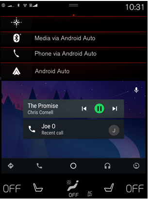

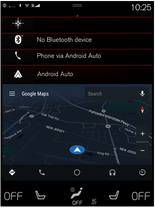

You will still have access to the functions in your Volvo, if you choose, while connected to Android Auto.  You will not be able to simultaneously run the same function from Sensus and Android Auto.  For example, if you choose to use your Volvo's navigation to reach your destination you will not be able to also use Google Maps through Android Auto.  You will, however, be able use your phone or listen to your music through Android Auto.  When the source is being transmitted through Android Auto the Sensus screen will read that is available in Android Auto:
